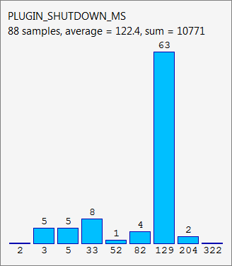

The histogram below is taken from Firefox’s about:telemetry page. It shows a histogram used for tracking plugin shutdown times and the data collected over a single Firefox session. The timing data is grouped into buckets where the height of the blue bars represents the number of items in each bucket. The tallest bar, for example, indicates that there were 63 plugin shutdowns lasting between 129ms and 204ms.
../../../../_images/sampleHistogram.png
The histograms on the about:telemetry page only show the non-empty buckets in a histogram, except for the bucket to the left of the first non-empty bucket and the bucket to the right of the last non-empty bucket.
